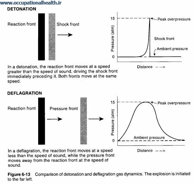

نموداری بسیار زیبا جهت بیان تفاوت Deflagration و Detonation
Deflagration
A propagating chemical reaction of a substance in which the reaction front advances into the unreacted substance rapidly but at less than sonic velocity in the unreacted material
Detonation
A propagating chemical reaction of a substance in which the reaction front advances into the unreacted substance at or greater than sonic velocity in the unreacted material

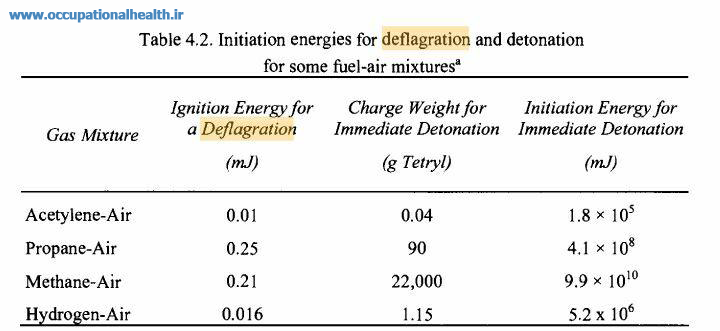

مقایسه انرژی (میلی ژول) مورد نیاز چندین مخلوط قابل اشتعال جهت شروع Deflagration و Detonation.
همانطور که ملاحظه می فرمایید انرژی بسیار بالایی جهت ایجاد Detonation نسبت به Deflagration لازم میباشد.
Depending on source properties, ignition can lead to deflagration or detonation. Deflagration is by far the more likely mode of flame propagation to occur immediately upon ignition. Deflagration ignition energies are on the order of 10"4 J, whereas direct initiation of detonation requires energy of approximately 106 J
Table 4.2 gives initiation energies for deflagration and detonation for some hydrocarbon-air mixtures (initiation energies for immediate detonation were converted from explosive charge weights shown in the table). Considering the high energy required for direct initiation of a detonation, it is a very unlikely occurrence
